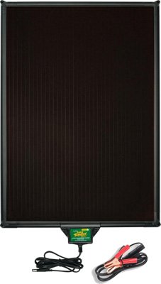

as for solar panels, cant get much simpler than the deltrans panels.  i run one at camp sites and while my camper sits in the storage lot to keep the batteries topped off.  they come with a quick disconnect to hook to the battery
http://www.amazon.com/Battery-Tender-10-Watt-Built--Controller/dp/B007N7VLWO/ref=sr_1_7?ie=UTF8&qid=1429919775&sr=8-7&keywords=battery+tender+solar+panel
