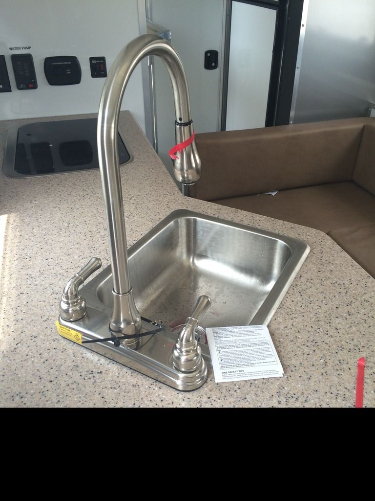

[p]For those who want to know what LivinLite will do in the way of solid surface countertops with upgraded sink and faucet here is a picture of what they did for our custom 21BHS. $500 upgrade.[/p][p]
[/p][p][a href="http://s304.photobucket.com/user/bvabob1/media/Our%20New%20Camper/image.jpg4_zps0tfxl1ce.jpg.html"]
