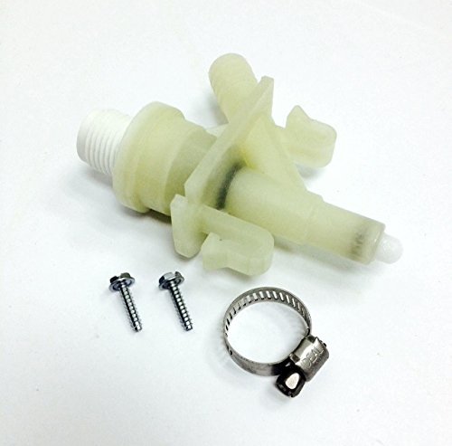

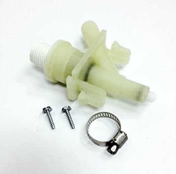

It would be helpful to those not familiar with the toilet valve to describe how to remove it from the toilet. I know it may seem easy to you, but a little more info would be nice.
Also....pictures would be a great help. In regards to installing a "Y" valve at the fresh water tank and the pump hose, is this pretty self evident?? I will get under my 21 RBS and hope it is as easy as I am reading here. It seems that being able to put a tube on the "y" below the trailer, into the bottle of pink stuff, would be a more direct installation than the Camco kit, which is installed above the floor at the intake of the pump. From what I understand, you install a tube from their valve into the pink stuff bottle and turn on the pump. Since it is that time of the season, I want to install the valve, with preference to underneath the trailer. Any further illumination regarding this is ALWAYS appreciated.
Happy Trails.....
Here is a picture of the flush valve.
kycamper
Great response David !! Thanks !! ( I didn't want to bring up the photo thing again. I'm hoping, too ). I'll do it your way. Seems like a straight forward fix to me.
[quote timestamp="1446492728" author="@david" source="/post/16411/thread"]Here is a picture and description of the flush valve (I am anxiously awaiting the ability to post these directly- hint, hint): http://www.amazon.com/Dometic-385311641-Sealand-Water-Valve/dp/B00W98ICDS/ref=sr_1_3?ie=UTF8&qid=1446492437&sr=8-3&keywords=dometic+flush+valve
