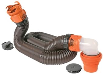

I ordered a Valterra 64" hose carrier from Amazon to replace the much shorter one Livin Lite supplied. Fit right into the same slot:
Its to hold the 15' RhinoFlex hose we got, also from Amazon.
I'm considering mounting the shorter carrier and hose on the other side. 15' should be enough most of the time, but when we camped at Hiawassee, some of the sites had fairly long distances to the sewer hookup, so a bit extra hose for those times might come in handy.

[quote source="/post/1450/thread" timestamp="1402485989" author="@fasteddieb"]Its to hold the 15' RhinoFlex hose we got, also from Amazon.[/quote]
Have you tried installing the hose yet? Because we initially purchased the same carrier and found that it actually didn't fit. You'd think that the most popular hose and the most popular hose carrier on amazon would be compatible, but they weren't. The hose could fit with modifications (trim some of the lugs), but the sewer adapter didn't fit at all. Had to return it for the D&W super tube. The 60" super tube also happened to line up with the floor joists.
fasteddieb
I was prepared to shave down some lugs to get it to fit, but it slid right in - with everything but the orange "cone adapter".
This is the one we got:
Interestingly, it shows as $17 online, but was about $7 in the store - I would not have paid $17 for it and would have opted for RhinoFlex connectors instead. Still may.

shovelhead
[quote source="/post/1455/thread" timestamp="1402492200" author="@tinkeringtechie"][quote source="/post/1450/thread" timestamp="1402485989" author="@fasteddieb"]Its to hold the 15' RhinoFlex hose we got, also from Amazon.[/quote]Have you tried installing the hose yet? Because we initially purchased the same carrier and found that it actually didn't fit. You'd think that the most popular hose and the most popular hose carrier on amazon would be compatible, but they weren't. The hose could fit with modifications (trim some of the lugs), but the sewer adapter didn't fit at all. Had to return it for the D&W super tube. The 60" super tube also happened to line up with the floor joists.
[/quote]What is the D&W Super Tube and where did you buy it?    I did an Amazon search but found nada  Thanks
Dave
[quote source="/post/1463/thread" timestamp="1402499309" author="@fasteddieb"]I was prepared to shave down some lugs to get it to fit, but it slid right in - with everything but the orange "cone adapter".[/quote]
So where are you going to put the adapter? When that didn't fit, it was a dealbreaker for me. If I'm going to store poopy parts in a box somewhere in my rig I might as well just put the hose there as well. No reason to have multiple poopy storage areas.
[quote source="/post/1464/thread" timestamp="1402505329" author="@shovelhead"][quote source="/post/1455/thread" timestamp="1402492200" author="@tinkeringtechie"]Have you tried installing the hose yet? Because we initially purchased the same carrier and found that it actually didn't fit. You'd think that the most popular hose and the most popular hose carrier on amazon would be compatible, but they weren't. The hose could fit with modifications (trim some of the lugs), but the sewer adapter didn't fit at all. Had to return it for the D&W super tube. The 60" super tube also happened to line up with the floor joists.
[/quote]What is the D&W Super Tube and where did you buy it?    I did an Amazon search but found nada  Thanks[/quote]Here's the super-tube:
[a href="http://www.dwincorp.com/products/82/SUPER-TUBE"]http://www.dwincorp.com/products/82/SUPER-TUBE[/a]
The 60" version fits perfectly where Eddie put his carrier. The mounting holes also line up with the floor joists, so it attaches very securely. They have a new adjustable one that just came out:
[a href="http://www.dwincorp.com/products/125/NEW-SUPER-SLIDER-Adjustable-SUPER-TUBE"]http://www.dwincorp.com/products/125/NEW-SUPER-SLIDER-Adjustable-SUPER-TUBE[/a]
I haven't seen it myself though, so I'm not sure if it's as sturdy as the original.
