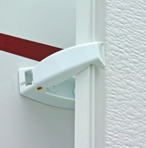

After reviewing all the options posted here we went with the clips. Used 3M VHB double sided tape to secure them to the ceiling. Work great and installed them on all 3 up opening cabinets.
My wife's been after me since we bought our 21BHS and Friday we finally did the same as what you've described. Seems to work fine for now but if they fall off, I'll put more thought in to using struts again.

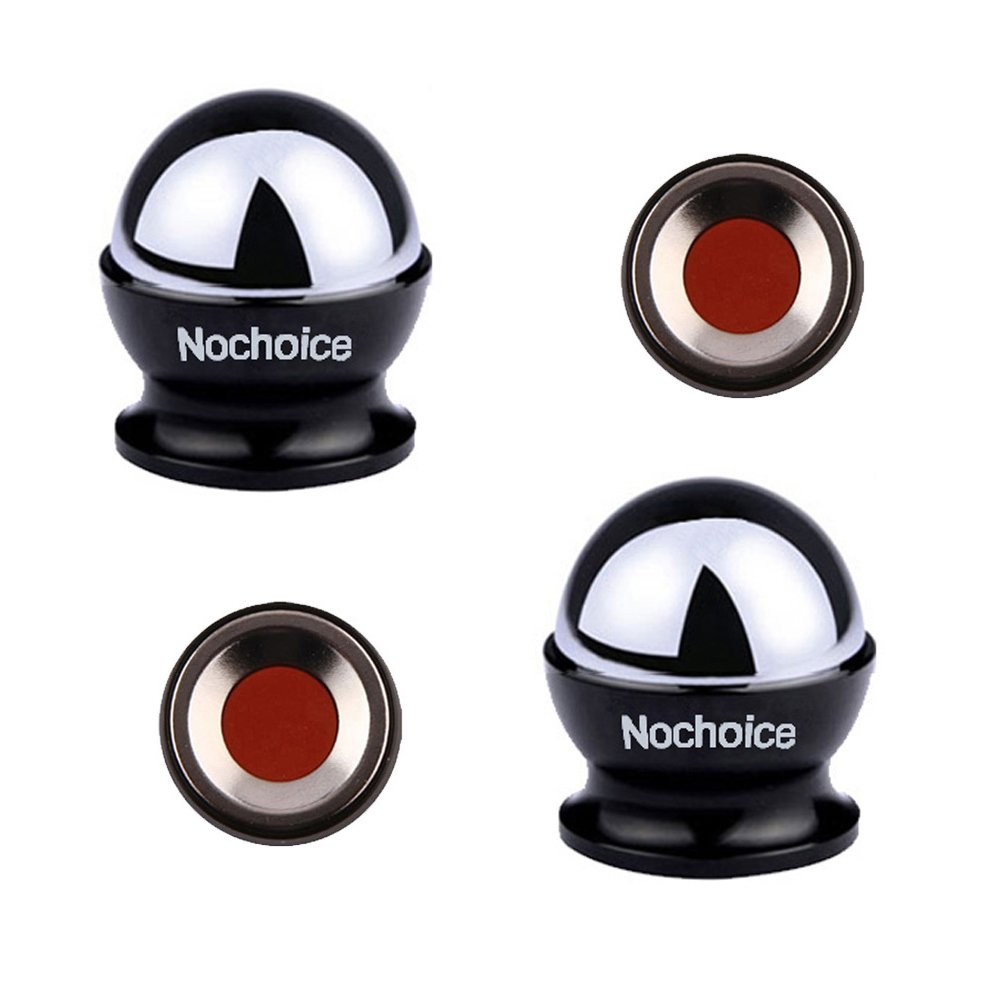

Quote from: @thudd3r" source="/post/11764/thread" timestamp="1433036621tinkering's post got me thinking.  i hate having to hold the doors up while loading/unloading..so i added catches as well.  after finding that all of the magnetic catches designed for doors/cabinets that i liked came with silly prices, i ended up buying a couple pairs of these...
[img style="max-width:25%;" style="" src="http://ecx.images-amazon.com/images/I/61TuhZYbQXL._SL1002_.jpg"]
http://www.amazon.com/gp/product/B00TK01CSU?psc=1&redirect=true&ref_=oh_aui_detailpage_o00_s00
 they are made to hold cell phones.  i liked the ball idea since the doors would probably meet the ceiling at an angle.  the magnets are really strong and they come with quality 3m adhesive to mount them...just peel and stick...couldnt be simpler (and the$13 price was pretty sweet as well)

My Balls have arrived today....  Can't wait to install them....
 8D
balls of steel

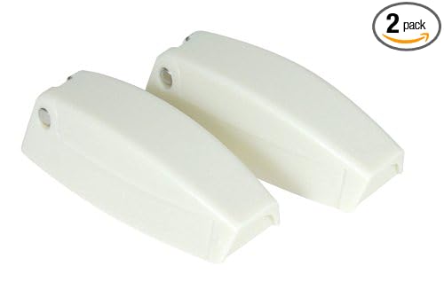

$16 kit off Amazon, leaves me one extra to kick around the garage until I throw it away in six years:
https://www.amazon.com/gp/product/B01AHHCHBK/ref=oh_aui_detailpage_o01_s00?ie=UTF8&psc=1
