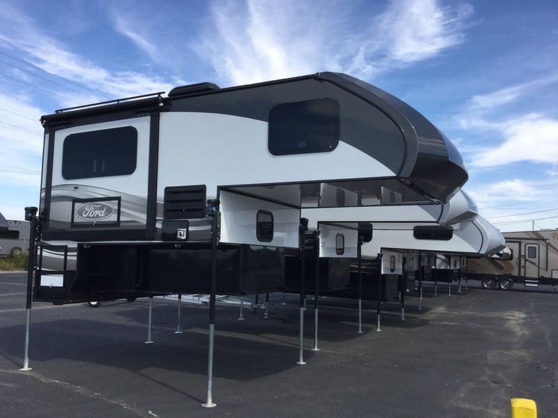

Thought you might like this. They are developing a TT with the Ford brand soon too. It will unfortunately have a steel frame. It will be the only TT they will build with a steel frame.
Had a chance to visit LL factory yesterday and got some good info I'll share later.
[a href="http://s304.photobucket.com/user/bvabob1/media/LivinLite%20Factory/image_zpshk0vgk5o.jpeg.html"]
[img style="max-width:100%;" src="http://i304.photobucket.com/albums/nn197/bvabob1/LivinLite%20Factory/image_zpshk0vgk5o.jpeg"][/a]
[p] Thanks for the pics. Those are some pretty awesome looking TC's. This is huge for LL....and a big win for Ford too.  8-) I did hear it is a compromise on some of the dyed-in-the-wool LL attributes. But that's Ford for you. Too big to fail and powerful enough to back that up..[/p]
I will bet that Ford specified a steel frame for their branded trailer as a resut of a simple marketing need. Their trucks have steel frames and aluminum bodies, so how could they promote an aluminum frame in a trailer pulled by a steel frame truck?
